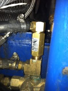

My Boxxer is dumping water into the waste tank. I thought the hot water dump valve was bad, so I replaced it. That wasn't the problem.
Any ideas?

Charlie Lyman
my machine never did this.
I replaced the 180 degree thermal valve. Took care of the problem.

HMs don't dump water at all times. The exhaust diverter is suppose to control the heat without a lot of dumping. It seems to work correctly on my Boxxer 421.
