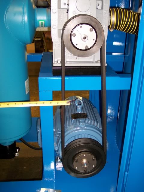

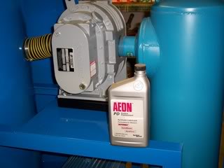

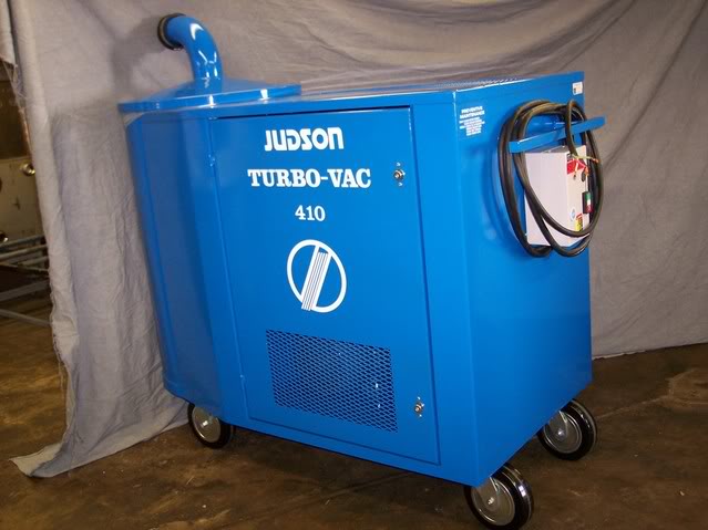

Kevin,
With the industrial vacuum systems we manufacture, we make the units universal for 45 U-RAI’s and 4MP Sutorbilts. As you can see in the photos, we do this by designing the unit for the Roots which is a 2 inch taller blower. We simply shim the Sutorbilt on 2 inch shims to get the shaft height the same so the same size belts will work. If you are trying to install a Roots instead of a Sutorbilt, you will have to lower the Roots 2 inches. We have tried to shorten the feet on a Roots, but you cannot get all the way down the complete 2 inches. There is still about an eighth of an inch where the housing of the blower will touch. Simply cutting the feet and lowering the roots will not drop it the full 2 inches. If you are going to put a Sutorbilt in place of a Roots, simply shim it on 2 inch thick 2 wall square tubes. This will get you close enough for a belt-driven system. If it is a shaft to shaft coupled system, you will still have to use thin shims to precisely line up the shafts.

Les, Mine are vertical airflow. Your pictures are horizontal airflow. Will that make a difference?
