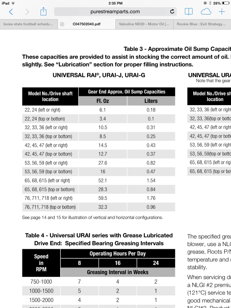

I'm changing the oil in a 33 blower. The manual says 10.5 fl oz.
I drained 2 cups out of it. Anyone have experience with changing the oil in these and know how much I should use?
Thanks.
18,851
Benton KY USA
Lee Stockwell
Depend on if the blower is vertical (pipes out sides) or horizontal (pipes out top and bottom).
In each spec noted above the larger volume is in horizontal configuration.
In either case yours' was overfilled, which is typical when someone doesn't know exactly how to check it, and just adds some out of guilt.

Also notice that the oil quantities listed in the table are approximate. To get the oil level exactly right, fill until the oil is level with the middle of the sight glass, if your blower has one. If it doesn't have a sight glass, then remove the oil overflow plug and fill until oil just starts to come out of the open overflow. Do this, of course, with the van parked on a level surface.

It doesn't have a sight glass. It does say in the manual to fill it until it starts to come out the overfill hole. It took 2 cups (16oz) to get there. Mine is mounted horizontal. I found another site that says the capacity is 16 oz.
