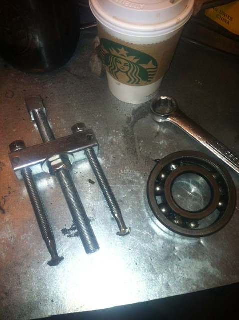

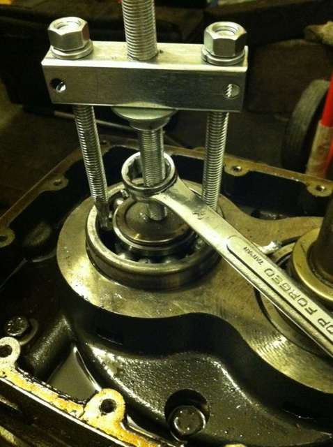

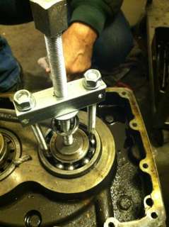

$10 in parts for this DIY bearing puller, it hooks on to the "inner race" of the bearing, bypassing the need to remove the blowers front plate to tap the bearing out!
I made this tool to replace the $700+ bearing puller that was stolen my grandfather gave me before he died.
I could replace both front bearings on any blower in less than 5 minutes.

Do some of the ball bearings need to be missing in order for the puller to fit? I suppose if the bearing is bad there is usually one or two missing.

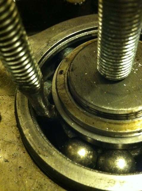

No, just the brace that holds all the bearings together, If it's still intact you just drill it out and use needle nose plyers to

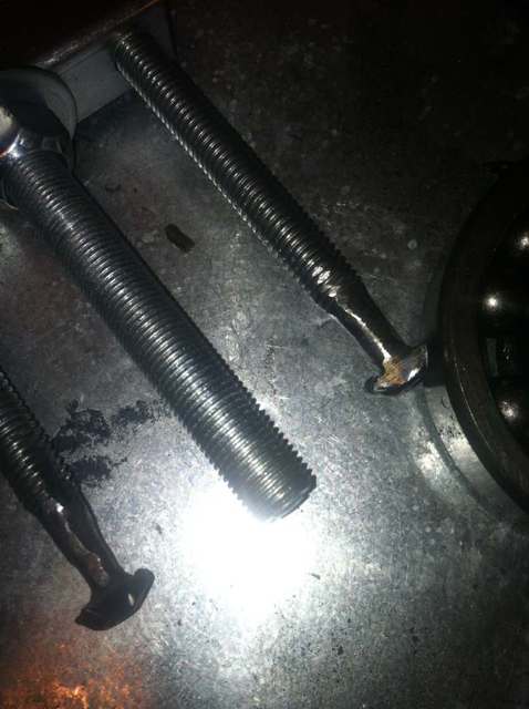

Even better would be to have 4 arms pulling, it would not need that wrench in the middle to brace it from moving side to side.
But that would cost an extra 'Buck fiddy.
