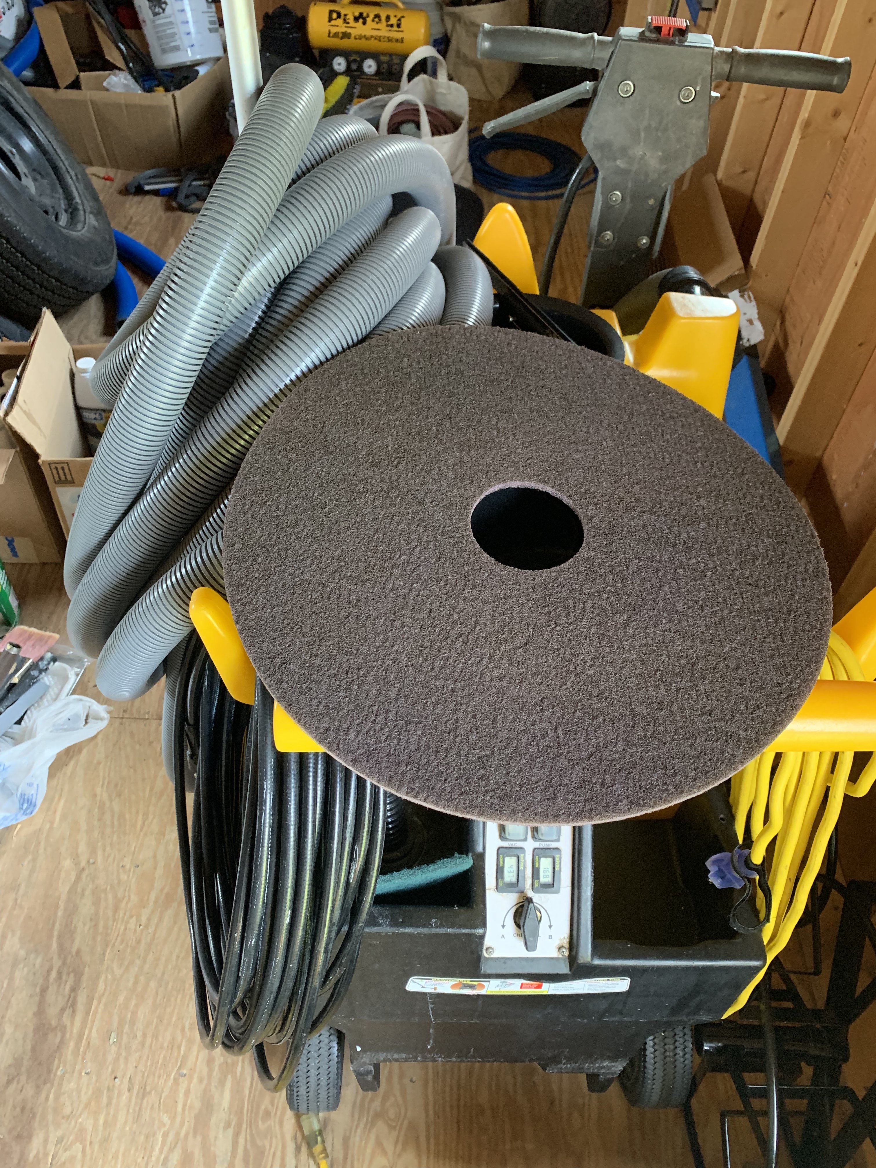

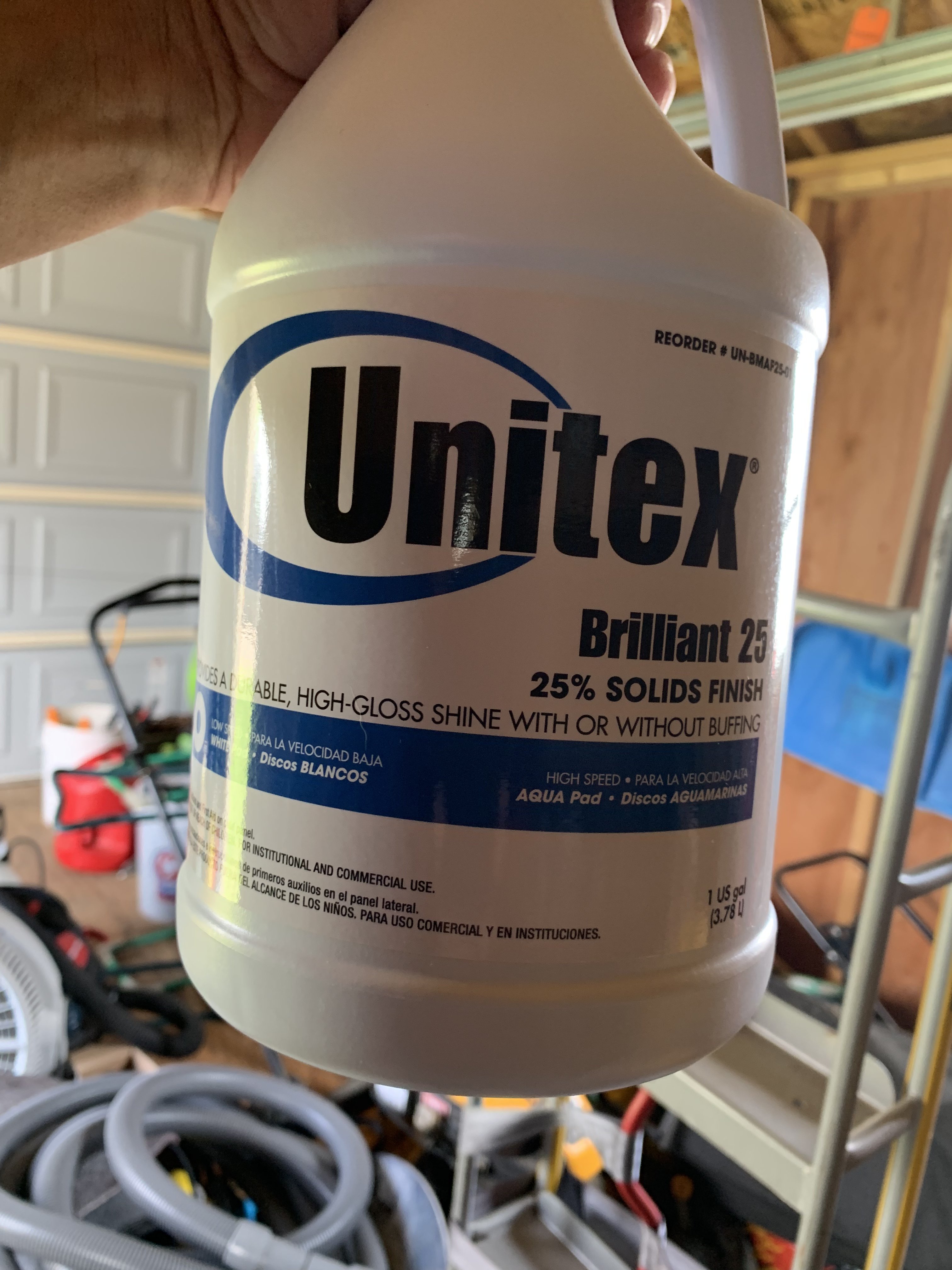

I’m going to apply the stripper let dwell scrub with my buffer and black pad
Vacuum up slurry with shop vac and Malay mop from edges first a thin layer of wax let dry and the. Scrub with white pad
Most finishes don't need polishing with white pad. Just mop on, let dry. Mop on, let dry. Mop on, let dry. Don't forget to mop rinse with neutral cleaner after stripping.

What you said too. I couldn’t read all of that above, but if someone said buff in between, that’s nonsense and a time waister. Fans don’t hurt, ive used them for years. Blowers are different. But small blower for air circulation is ok. Can shite fly, of course. It can without fans. Deal with it on the next application.
