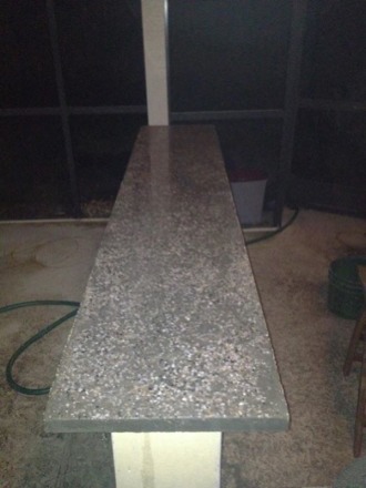

Best way to seal this counter top
davegillfishing
2,229
st augustine fla
dave gill
We are finishing the outdoor kitchen and putting this concrete top on it. We mixed shells and black rock in for the finish. It is wet down in this pic and we want the wet look all the time
Thanks for any help

http://www.roval.com/gloss_seal.htm
Dave, call this guy on Monday. Speak to Nick. I have been using a variety of their stuff for 5 years. Everything he has ever told me has been right on. He has also helped on a number of occasions.
On that page, I think your best bet is the 1088 sealer. I have used it on pavers with good success. It should enhance the concrete. You should be able to put multiple coats because it has leveling agents in it.
115,991
LOTS of concrete counters in these parts, own some myself
I recently came across work form these folks and they topically seal their tops with some real impressive looking stuff.
Give them a call before you do anything.
Personally I would not use a coating of any kind out doors, just a good (dry treat) penetrative so the slab can breath..
