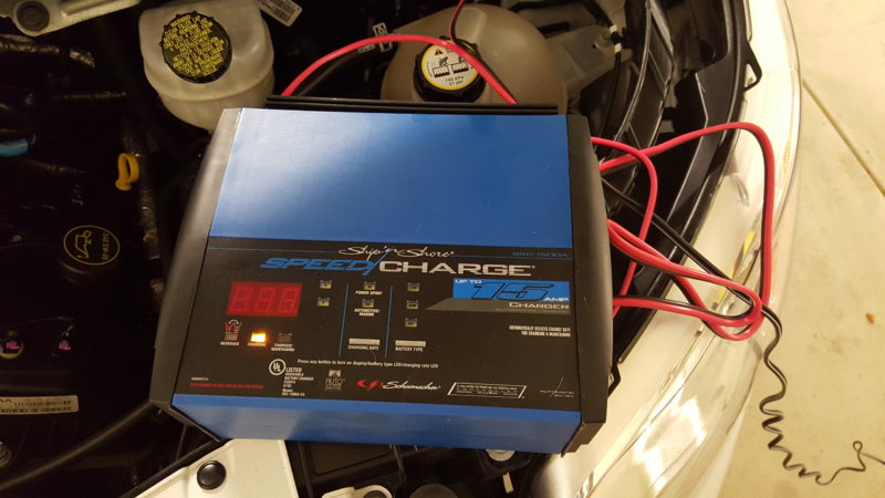

My mechanic buddy talked me into getting this thing to charge all my vehicle batteries every 4 to six months.
He says the four seasons drains them quick out here.
Never worried about it in Cali
But I was never impressed with my battery life either..
Any of you follow suit?

View attachment 10865 My mechanic buddy talked me into getting this thing to charge all my vehicle batteries every 4 to six months.
