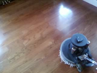

Use a white pad under your 175 with a some no rinse neutral ph cleaner, buff dry.

White pad will NOT scratch any of the finish..."of course..keep it damp with neutral cleaner"..
This process is very simalar to waxing a car...The neutral cleaner will dry to a haze...
Then you just buff it off....with a cotton or microfiber pad...

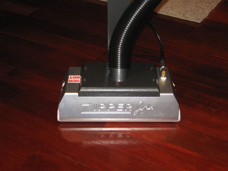

I have never seen this done before, it looks like a great up-sell. I've have rosewood floors in my kitchen with a lot of scratches in it. I would like to try my house for a guinee pig project. I have a clear coat poly urethane, is there a product and a method available that will make the scatches less visible without sanding and re-coating the floors? So many more people are going to hard wood floors, this looks like a great add on, like tile & grout cleaning. I just need to prove it to myself first. Does this really work and is this profitable?
p.s. The Zipper Jr. just happened to be in my photobucket, but now that you mentioned wood floors.....here's my questions, not a sales pitch!
