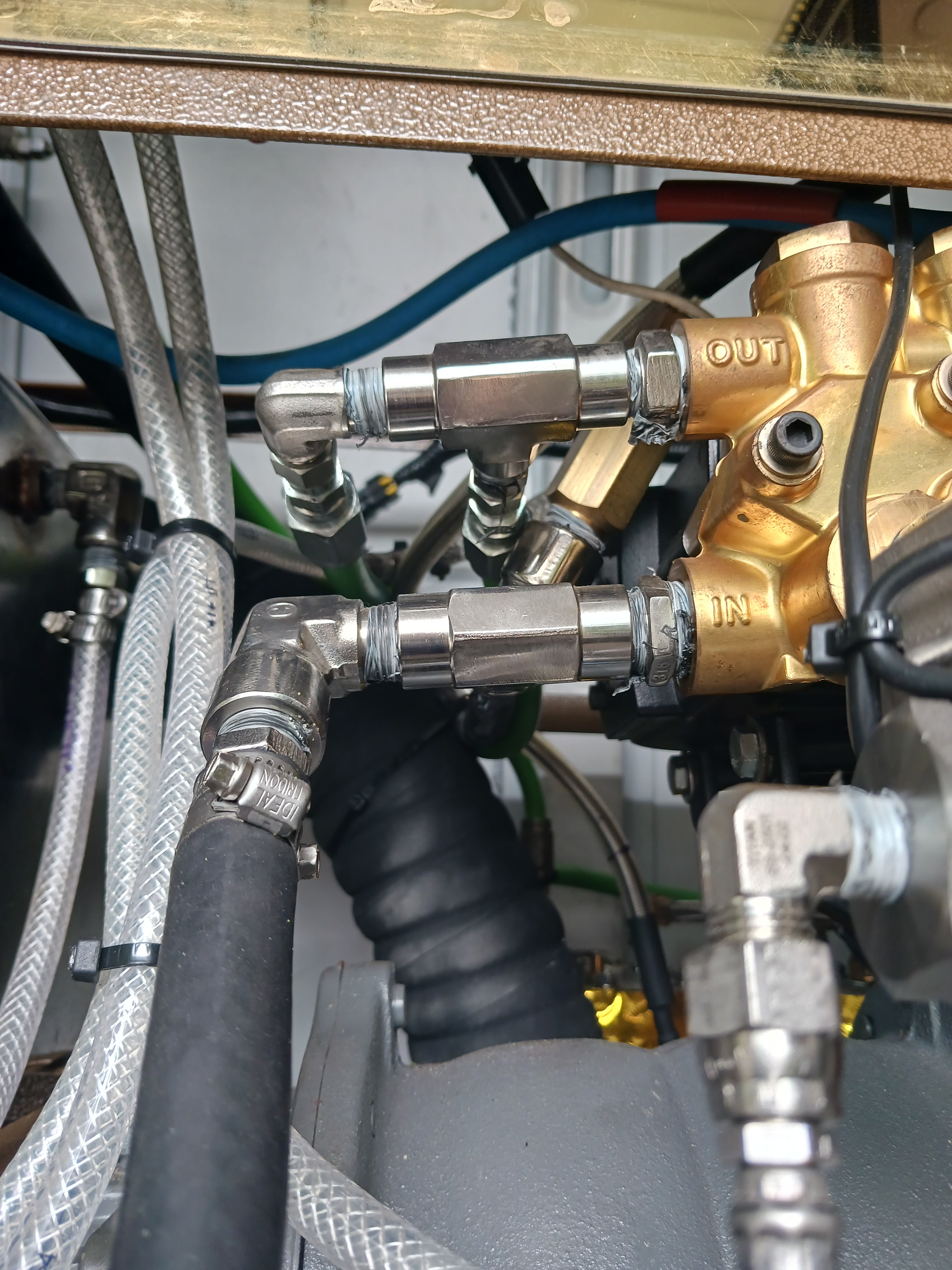

What would the extra cost be to put swivel connections on every hose end on said machine. It would make replacement-repairs infinitely easier.
Sorry busy showin off forgot to completely answer your question. All my fittings on Frankenstein are stainless so each hose cost me an extra 9.00 for the male jic connection on the machine (1.89 if it were brass) and additional 4.75 each for non working swivel end on the hoses . All my hoses are made with screw on ends apposed to crimp on but the price difference is about the same . So in short if you were to (and most manufacturers do) use brass the retail price is approximately 6.64 per hose more. Hope that answers your question
