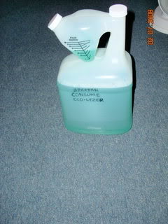

Greenie offered this tip for me today.... If you have a favorite pre-spray with known dilutions measure it once and pour it into your hydraforce. Then take a sharpie and make a line on the hydraforce. There you go - from now on no measuring cup needed. Too friggen simple.

i have a hydroforce revolution, and i have chemical feed on the machine. when i do have to measure i have a glass measuring cup.
putting the line on the hydroforce works but it quickly comes off if you get even a little prespray on it.
