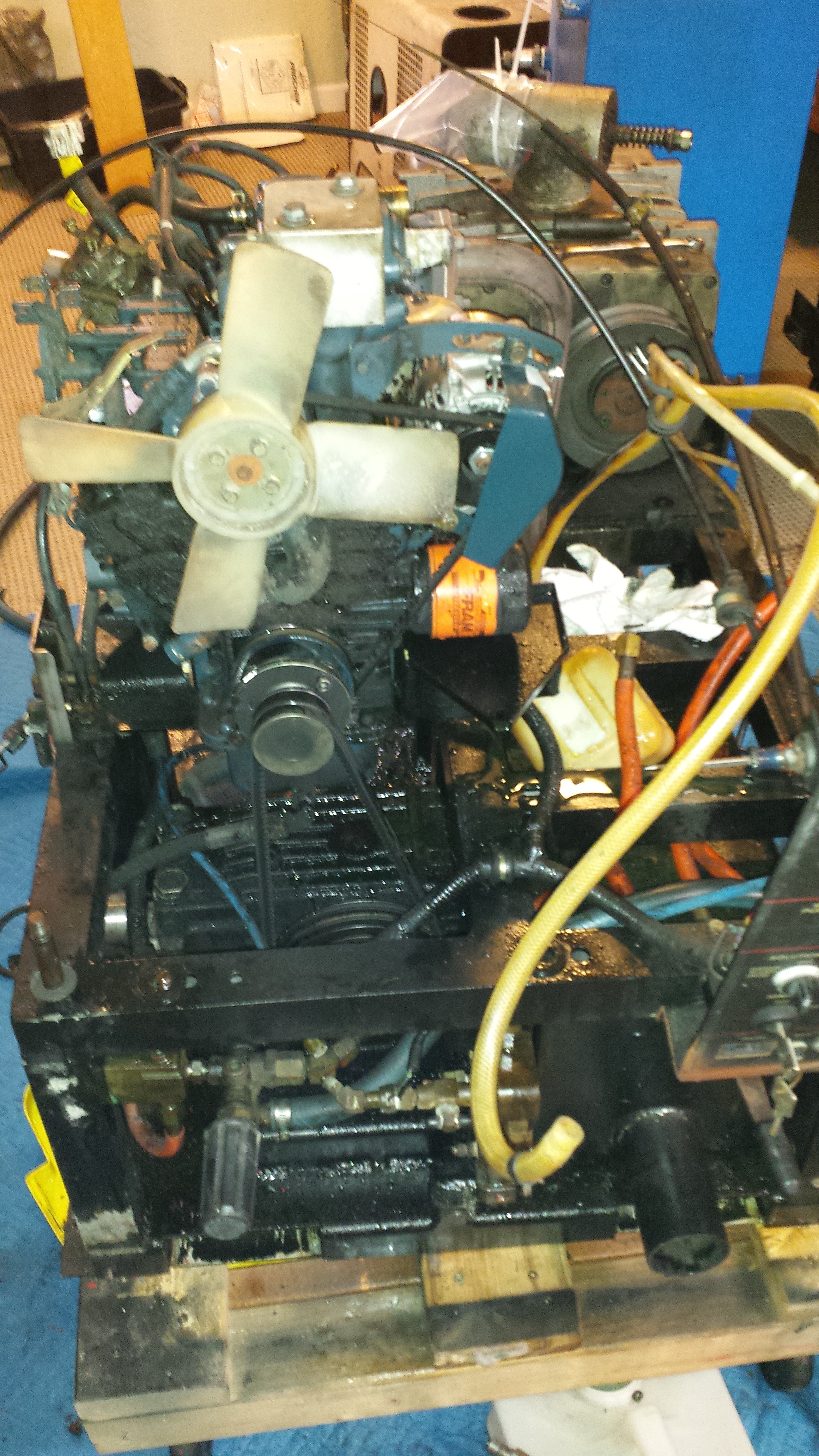

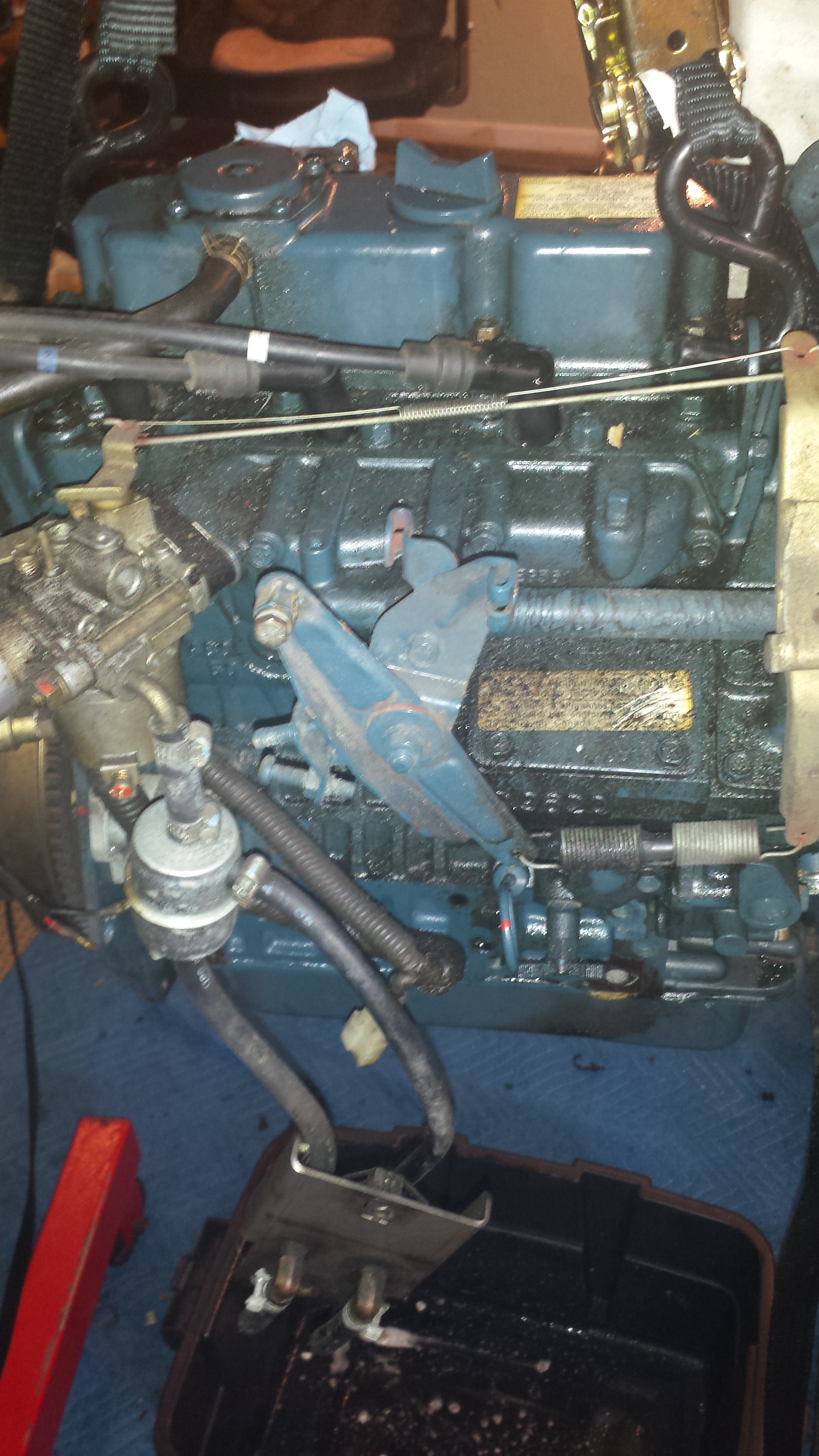

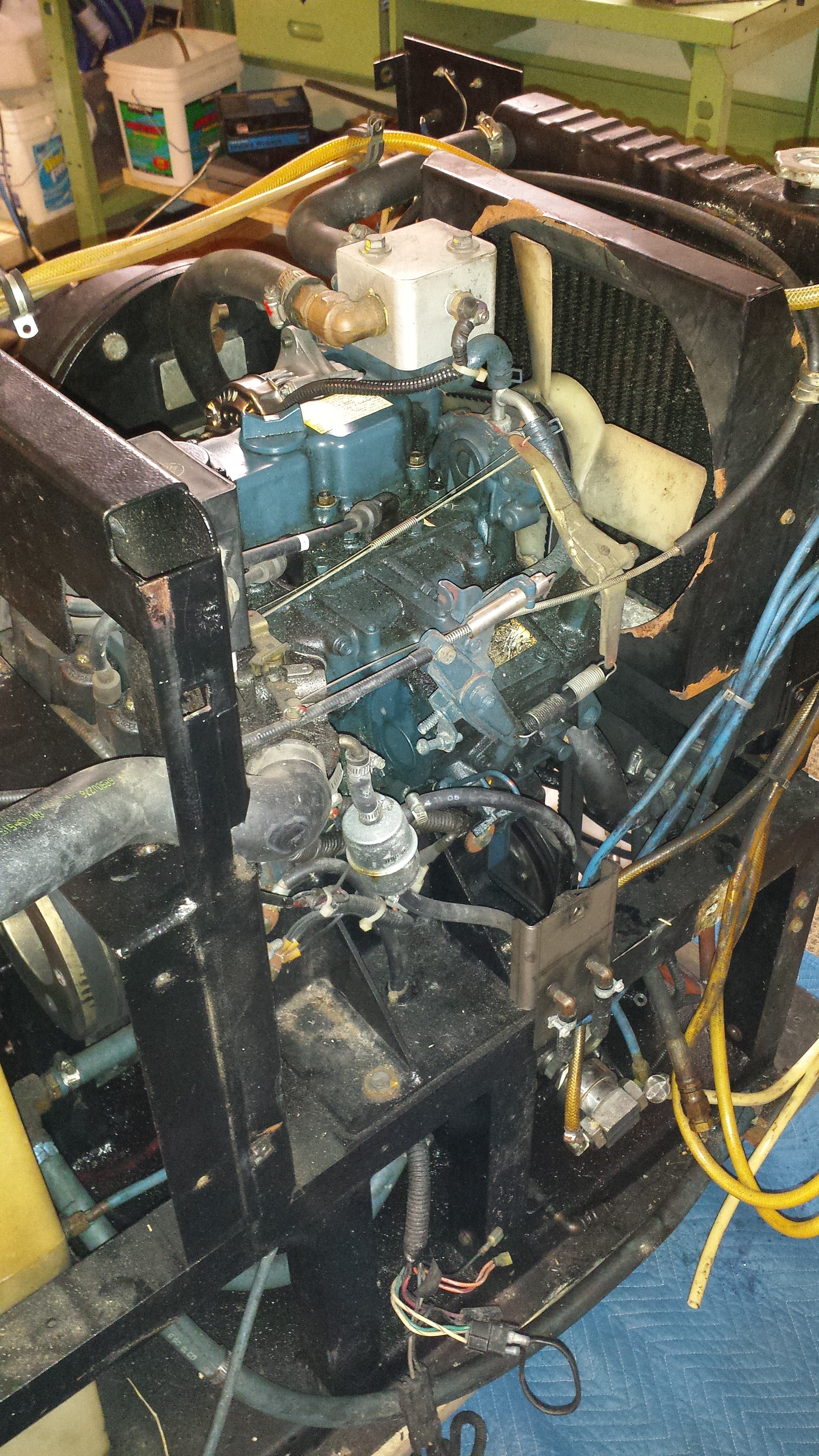

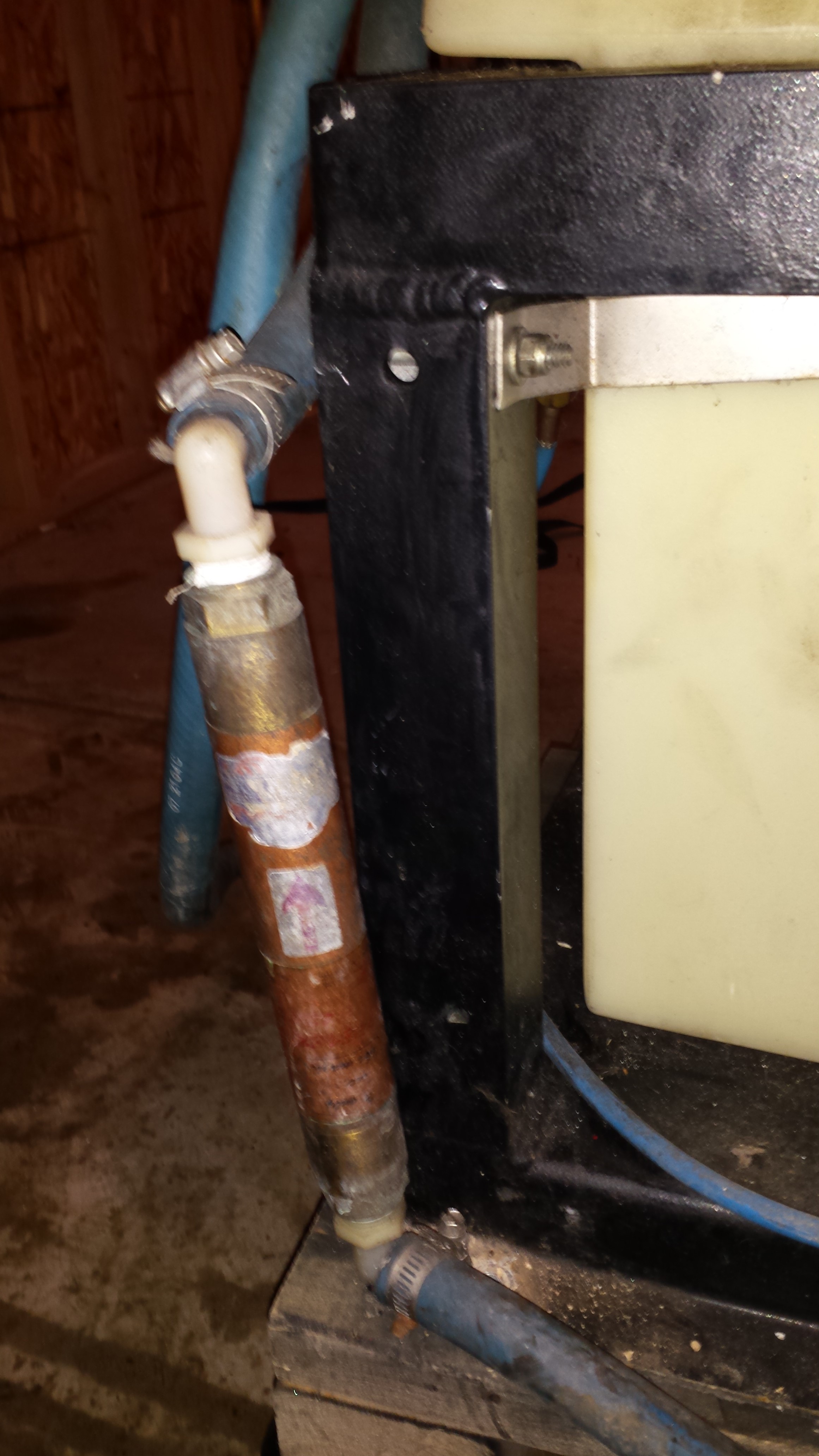

Keith I broke a copper pre-heat exchanger once too. At least you didn't break the stainless one. Just curious how difficult it was for you to reassemble the machine?
I took the heat exchanger into a radiator shop for them to take a look at..
If you just take one thing at a time both taking it apart and putting it back together it's not so hard. Just take your time and remember how everything is set up..
The worst thing for me is the wiring.. This time I checked all the wires and found 1 crispy one and a bad connector. .

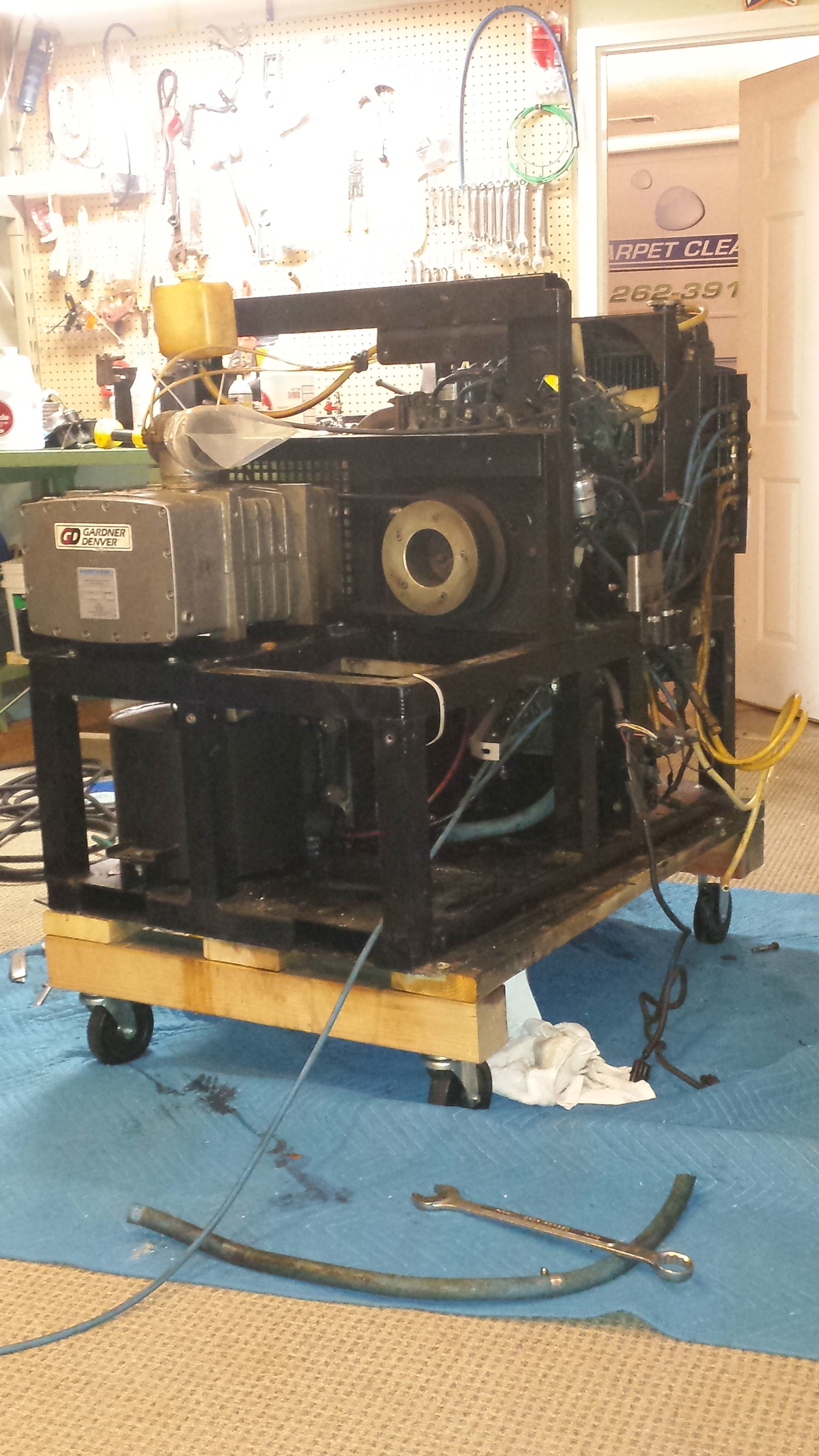

All new belts, new hardware, new low pressure hose, new air filter/fuel.. last time I replaced all of the high pressure, but I just replaced one on the high pressure side (it was a hydraulic hose) this time..

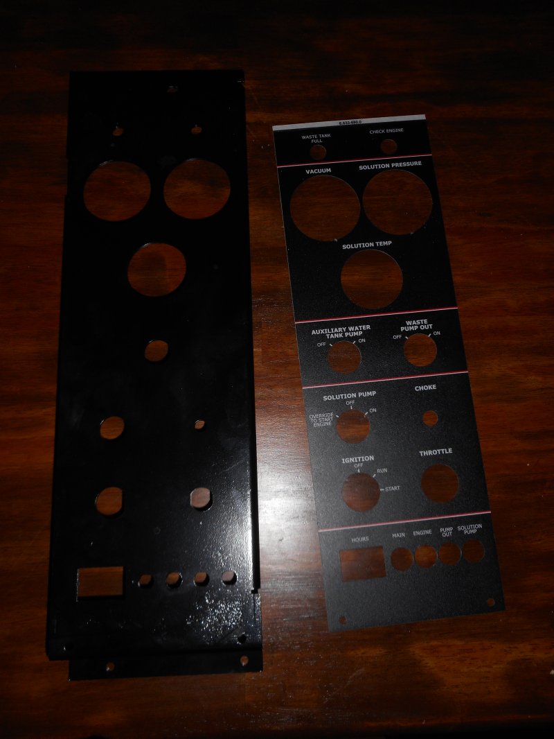

Shawn Abbey
Sep 20, 2008
115
Salem, OR
Shawn Abbey
Big hold up now is I can't get my hands on any stickers, or they cost $250 per I think I'm going to have it all hand painted. .
Here's a thought.
I tried this when I restored a motorcycle. Can you go to your local sign shop and have them duplicate the stickers? You can take pictures of another APEX, and have them duplicate them. That's what I'd do...

From here on out every sticker I buy will be scanned and made into a PDF file. Most places don't have the scanning ability because of the size. I went to a blueprint place that does vinyl today, they said no problem..:biggrin:. Wish Prochem would just send me there pdf's..

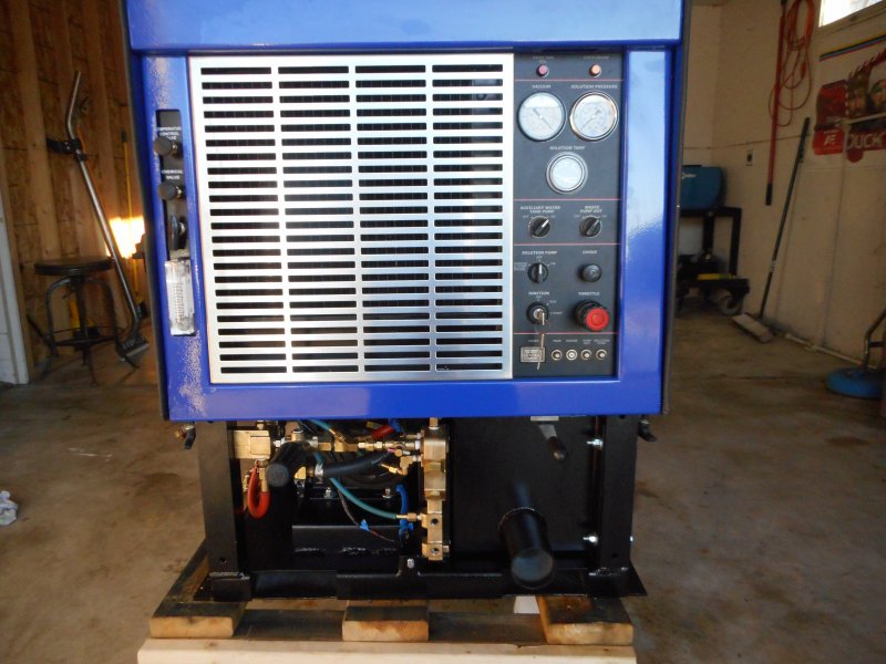

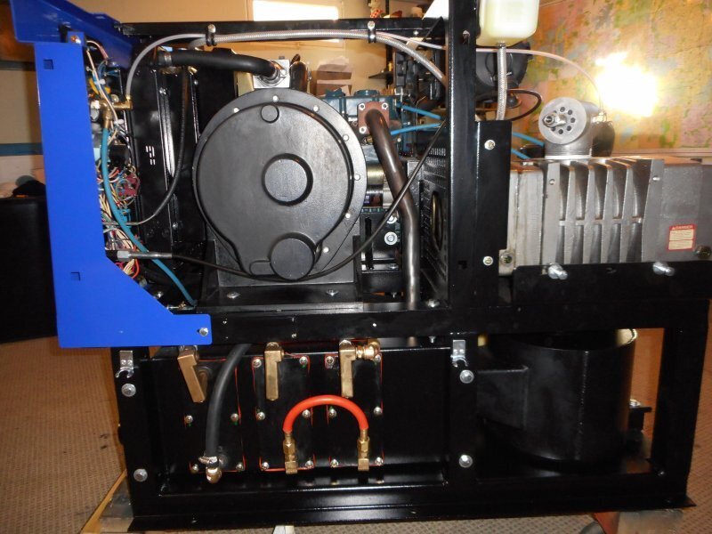

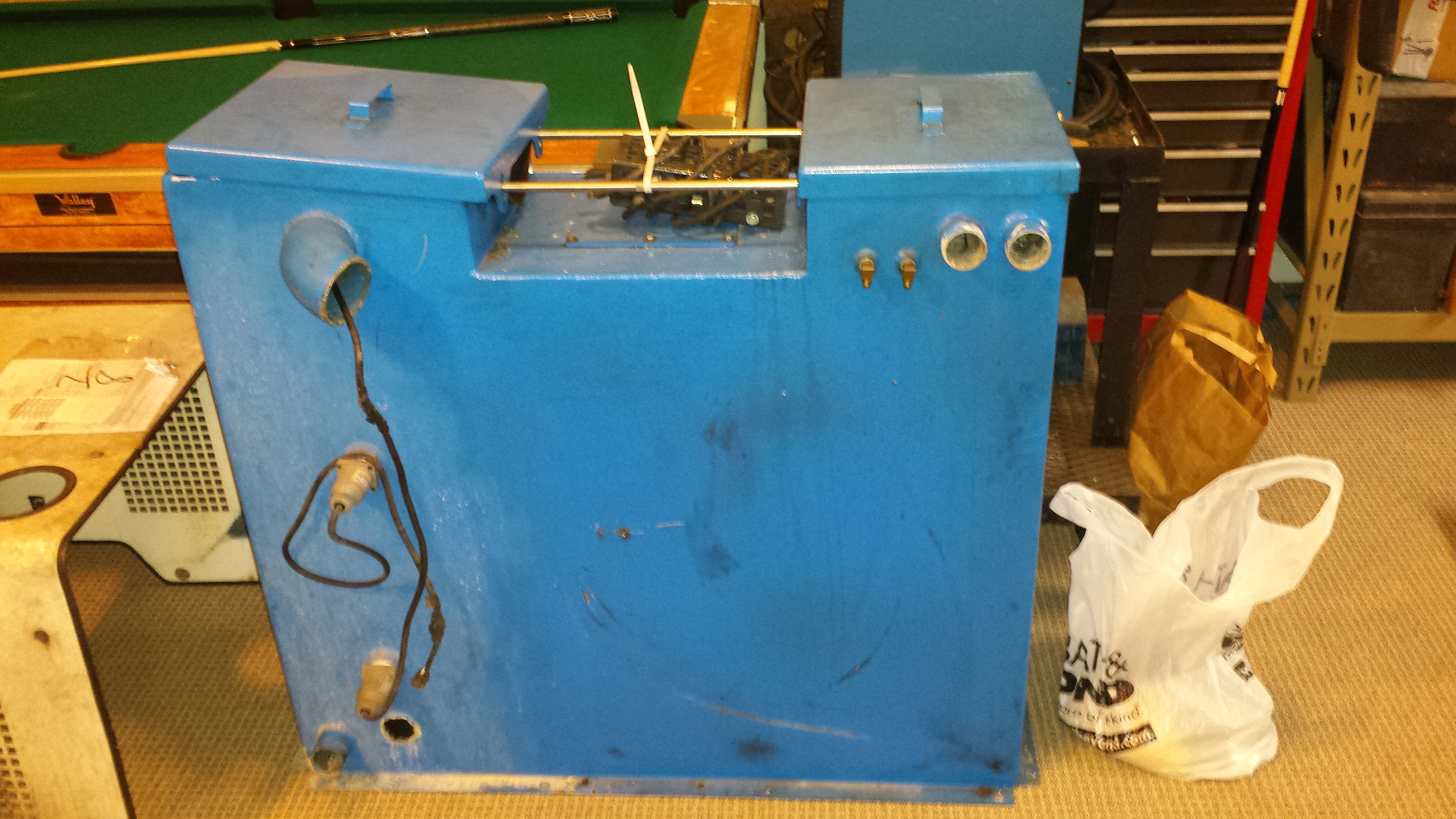

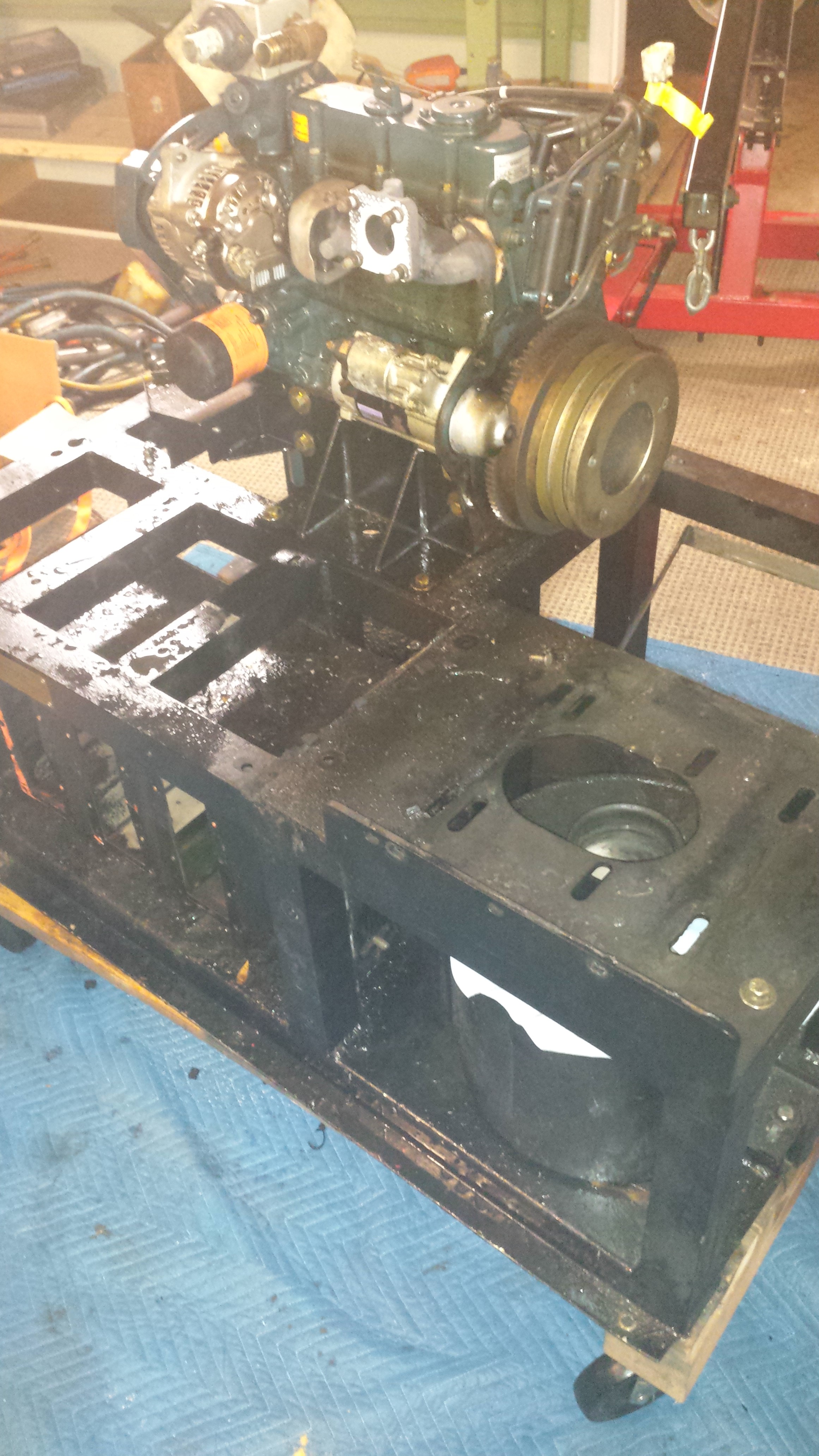

This one was a LOT of work, nothing went easy for example::madder:

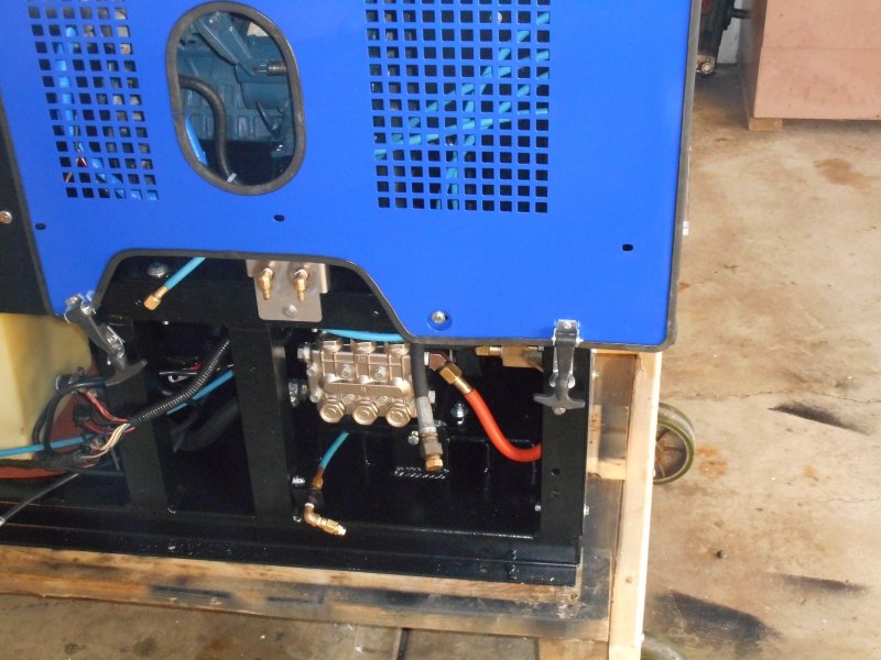

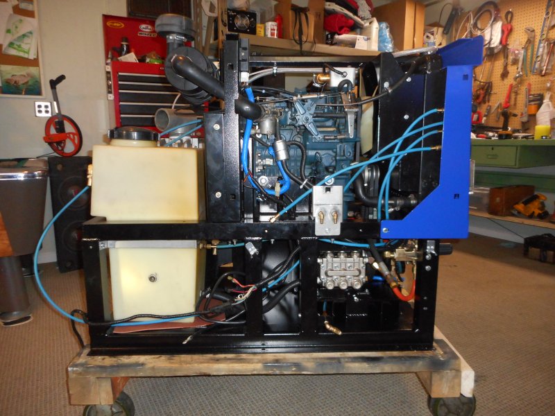

Plumbed and wired..

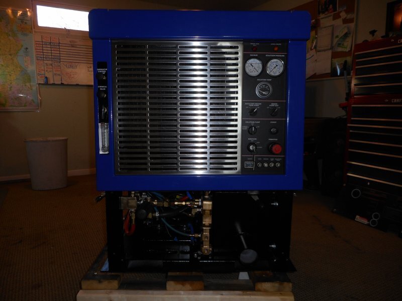

Planing to run it tonight..
I decided to go with these hood latches instead of putting the rattle clips back on..

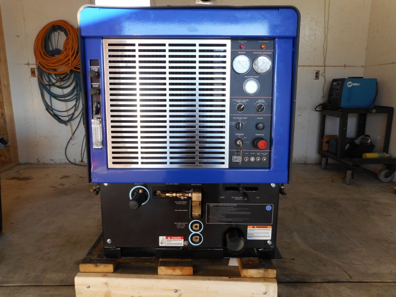

I took it in I'm going to have the whole thing skinned with sheet aluminum.
Doug Cox
Dec 17, 2006
4,881
Delavan, WI
Doug Cox
Here's a thought.
I'm having all my decals duplicated by the shop that does my van. The setup costs some money, but I can replace them anytime at little cost.
