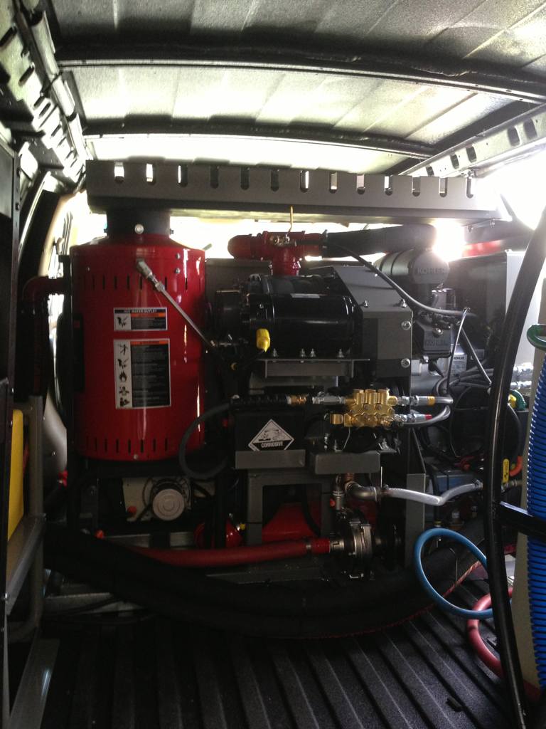

@Matt Wood tell us about what went wrong with your unit
Rust inside the plumbing built up so bad that the Dema kept getting clogged, causing major overheating. Then the water pump was mounted right in the hot zone, causing premature wear 3 times in the first 600hrs. Good ol Ben never learned that lesson. In fact, the new location is in an even hotter spot...right between the heat exchangers now. And don’t forget the lovely high tech Hypro brand. The dude is too cheap to put a general pump with high temp seals on it.
Next, it kept getting louder and louder with the 2 car mufflers that rotted out from the moisture coming from the waste tank. And he was so kind to put it in a spot where I would have to remove the truckmount from the trailer to get access to it.
And since we’re talking exhaust...the galvanized engine headers were wrapped in exhaust tape to get it so hot that it would burn in half. And when I ordered new headers, the home made metal flex pipe didn’t fit, so I had to drill more holes in the frame to get the heat exchanger to fit crooked.
And the thermal temp gauge was not the correct type of part to be mounted in the location he put it. It flattened out like a penny on a train track and failed.
All this in only 600hrs
