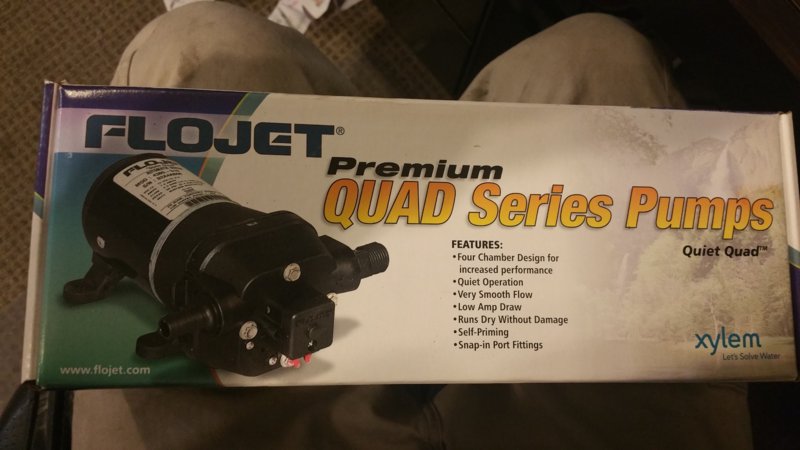

I have this one sitting here, I have installed it on HM truckmounts. It doesn't work for prochem because of the bladder tank.. Name your price, if it doesn't work for you send it back.
