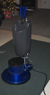

Apr 4, 2007
1,085
This Clarke was $200 On Craigslist I did the custom powder coat job on it.
