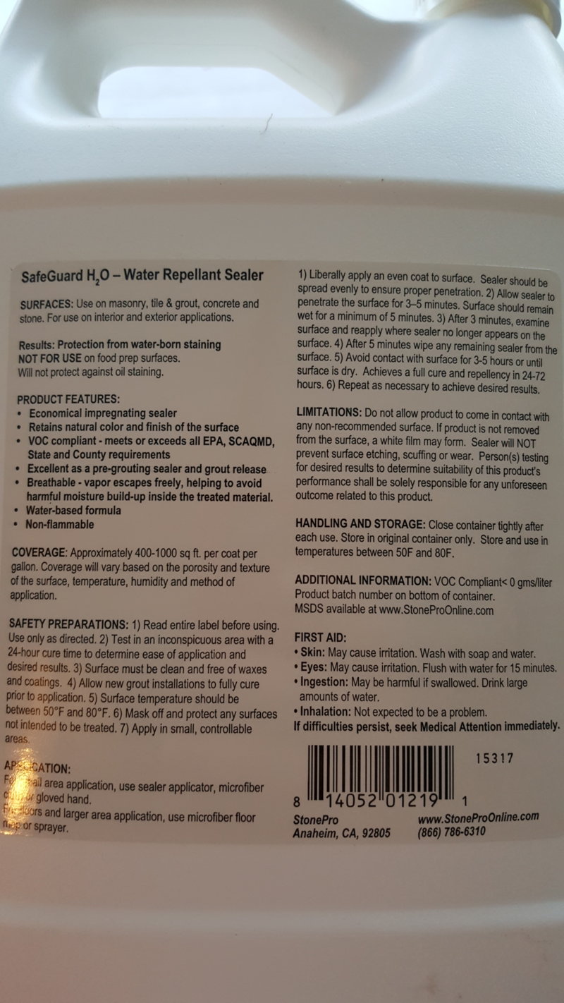

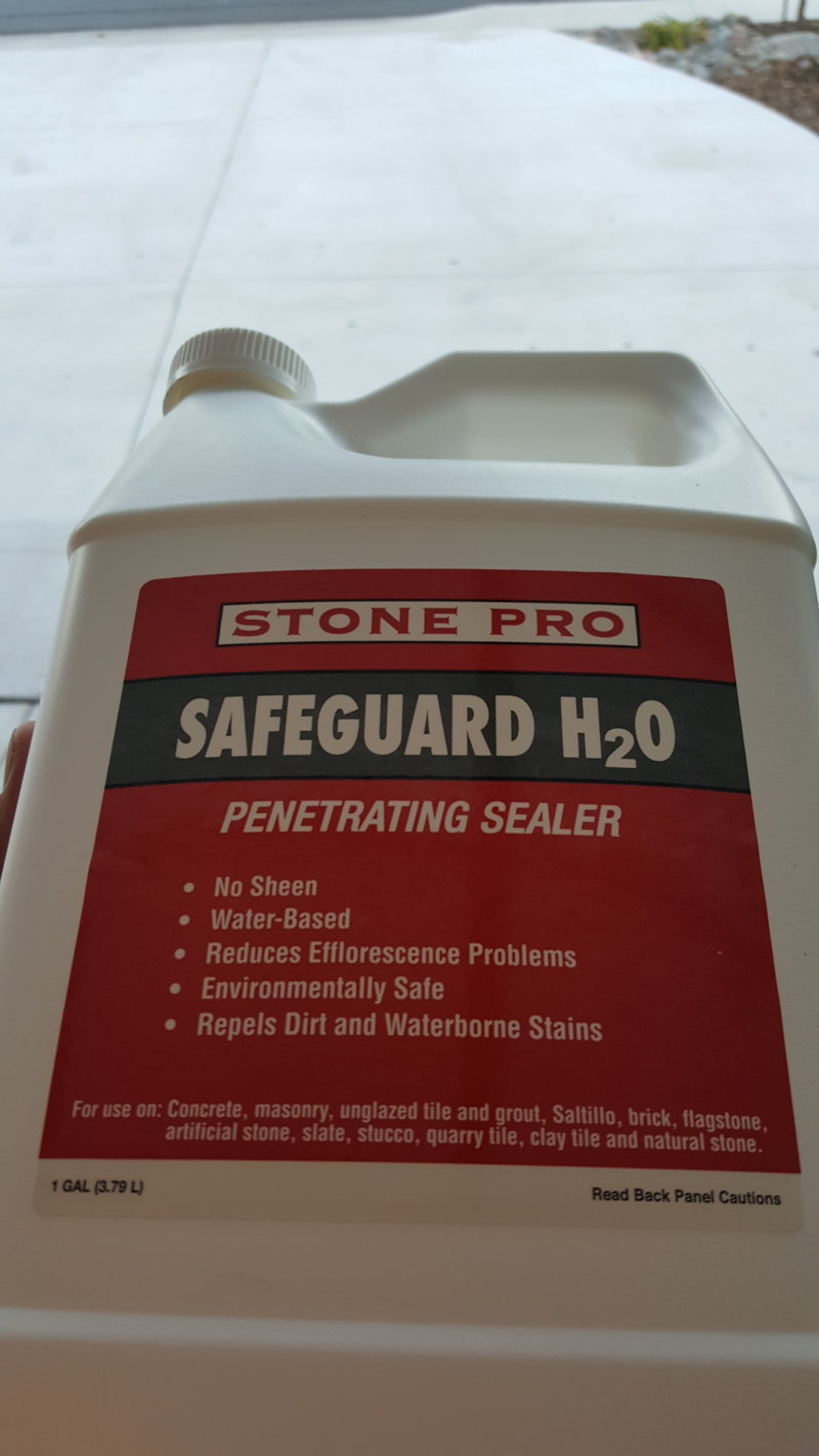

Amazing concrete penetrating sealer
115,932
I tried a popular solvent based that did less than zero to seal my drive way..
This suff on the other hand..
