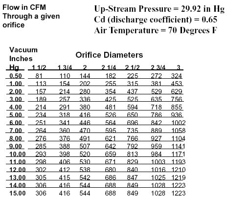

I'm going to give you a number...and you're NOT going to like it.
First of all let's understand that "lift" or vacuum is just another way to describe air pressure below atmospheric pressure. You can't get below absolute zero pressure, no matter how strong the device, you can only approach it.
Vacuum gauges show a range of 0-30 hg, but 30 hg doesn't exist. 29.92 hg is close to zero absolute pressure. Therefore it is accepted that 0.4912 psi is close to 1.0 hg.
ANSI has standards for air piping that reliably indicate how many standard cfm can flow through 2" pipe at various pressures. This is a curve, and you can plot it on graph paper.
5 psi 80 scfm
10psi 125 scfm
20psi 215 scfm
40psi 385 scfm
60psi 560 scfm
80psi 720 scfm
Some manufacturers claim cfm numbers near the top end of that scale, but there's a big problem. Look at it and tell me if you see it?

It is a little worse than that....
Look what actually happens at about 13" of lift. The CFM rise flattens out. At anything over 15", the CFM rises insignificantly.
The hose length will act as further restriction, potentially lowering the available CFM for the smaller wand orifice.

I was just thinking of science experiments. As already mentioned, and what was shown on Shawn's chart, were the qualifications or standard environment (darn, I've forgotten the term) which you need to duplicate in order to have a frame of reference. Ie having a standard temp and air pressure. The numbers may change based on elevation, thinner air.
So there will be ONE number, at one temp, at one air pressure, etc. It will vary from there.
Then you get into the restrictions and variables in equipment. Too many variables to get just one finite number.
