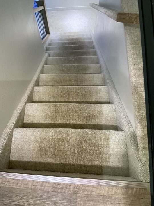

Good morning. I have a good customer who used adhesive backed plastic covering on his steps during construction. It was left on for about a year. He sent me this photo asking if I could remove the residue.
I am thinking to mist CitrusSolve, a wallpaper steamer to heat the affected areas really well and extract with my TM .
Have any of you ever ran into this type of problem? IMG_1710.jpegThanks for your input!

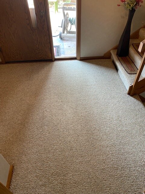

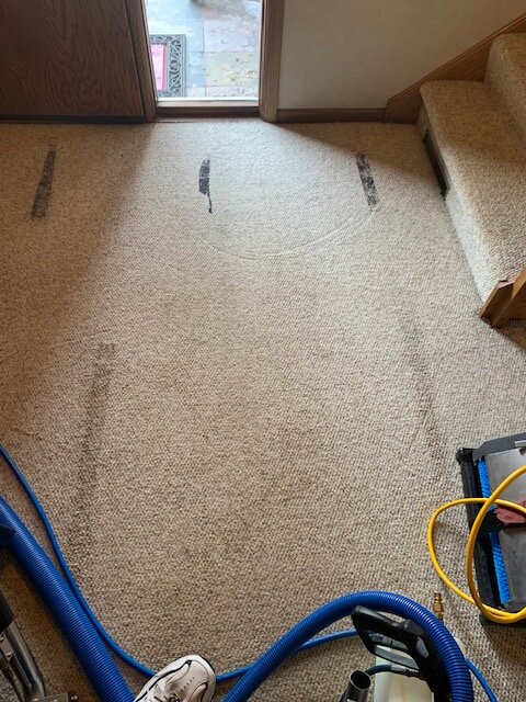

What process?
this was the entry from the garage. I cleaned the rest of the carpet (including steps which were WET when I took the picture) and started to work on the two strips in front with DeSovAll and ran out. Went to Home Depot and got an adhesive remover for carpet and that worked pretty good. Between DeSovAll, Citrus Force (diluted) and Home Depot Product and a lot of time, got it all out.
Reactions: Kenny Hayes
I think it looks damn GOOD!!!
