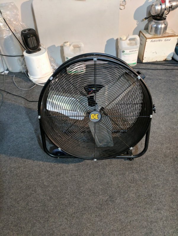

I am starting to use axial type fans instead of snail fans. I purchased a large 20 inch axial fan from a local pressure washing supplier to try it. $150. It works so well, I am going to buy several more. It is less pressure but over a much broader area. I usually get overnight drying with just one drieaz evolution dehu.
27,878
Here is a pic. It's actually 24 inches.
