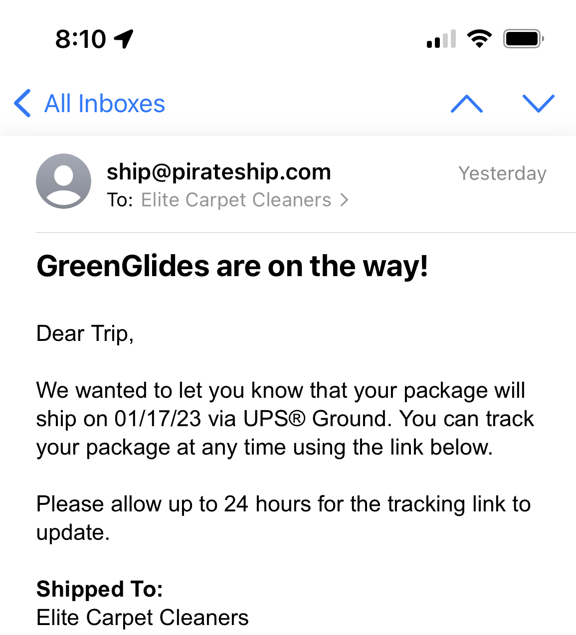

Well, I'm going to close out that invoice otherwise it screws up my QuickBooks. But the offer stands whenever you're ready
I’ll buy them. I was going to this morning. I just don’t want to get the slot. We talked about the hole and brush. Your the one that brought up old shit.
