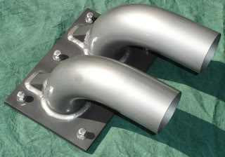

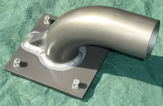

Greenie
6,820
Ya have to take the hack label as a compliment...lol Recovering Hack is also good.
Adding a second 2" port is a PITA, I would just replace my stock 2" with a 2.5" and be done with it. Something like this is universal, 2.5 slips over the outside, and 2" will slip inside, and it howls for airflow as RW pointed out.
or the double:
and you might want a mounted piece like this to plumb some hose from the elbow to the front of the machine:
or the double:
