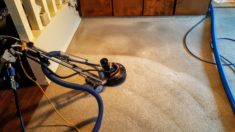

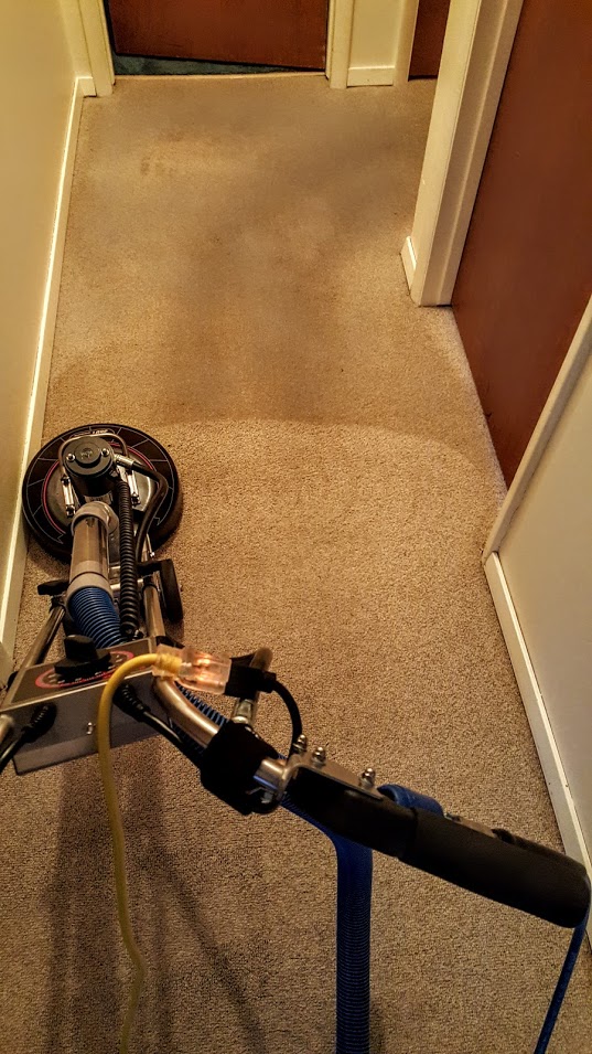

360i Brush Head..
115,929
is a winner.
I wish I would have tired this years ago when I had two "i's"...
no streaking and digs like mad..

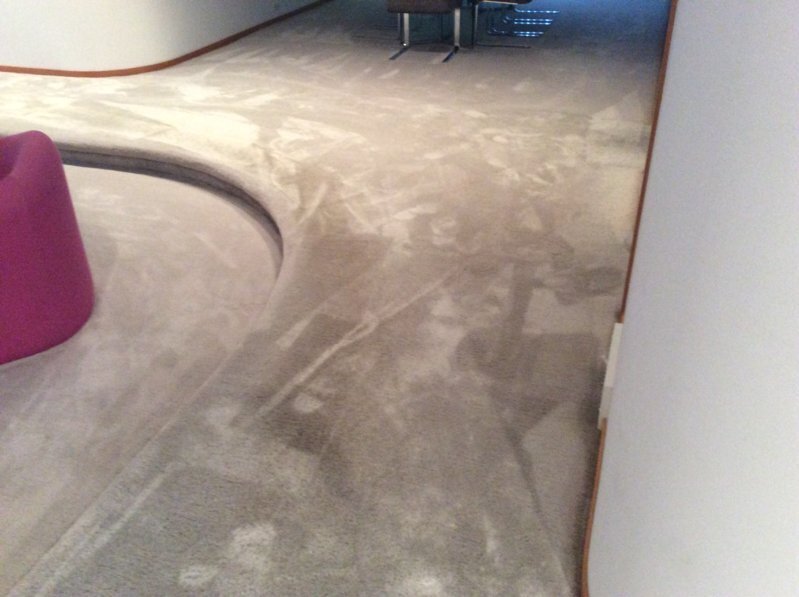

No tip bloom that I have seen, but I always prespray before hand. Plus the brush isn't so stiff that you break it in on concrete like a regular brush head. I tested it against a quad head on a hallway by a sunken living room last week
The brush head (used on the right) is more aggressive than the quad head (used on the left)
But there was no difference in the pile look when I wanded out the swirls.
