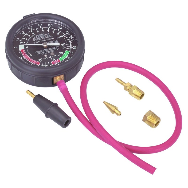

Invest in a cheap vacuum gauge to make sure the vacuum level is where it needs to be.
http://www.harborfreight.com/fuel-pump-and-vacuum-tester-93547.html
That way you'll know whether to look at the actuator or back at the lines etc. for pinholes, kinks, and such...

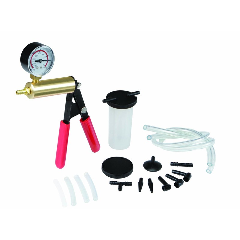

A common issue (on vehicles anyway) is the actuator diaphragm will develop a small leak. It will move some but the vacuum leaks off fast enough that it never achieves full travel. If you hook the hand pump up to a leaky actuator it will move as long as you keep pumping but will leak out and return to normal position as soon as you stop.
